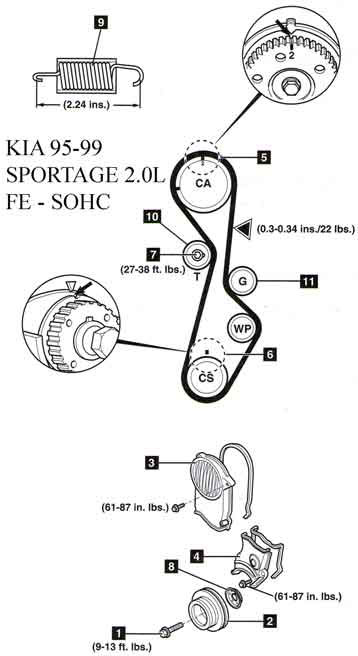

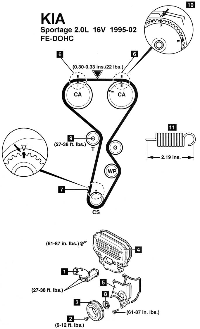

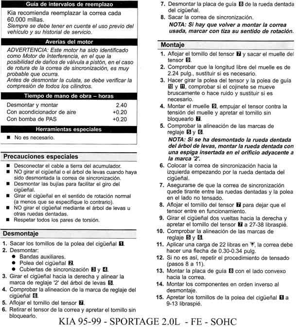

Reemplazando banda de tiempo en un Kia Sportage 2000 2.0L , comparto instrucciones. Sirve para Kia Sportage 2.0L años 1995 a 2002
1995-2002

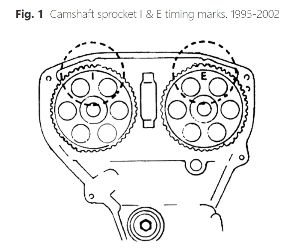

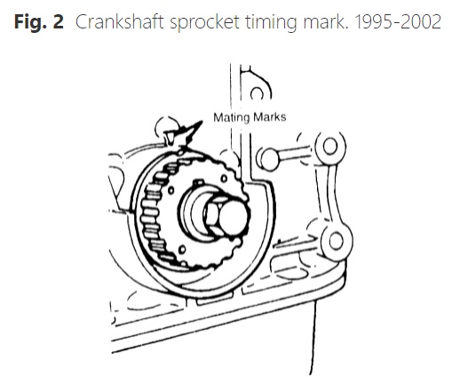

15.Align the crankshaft and camshaft sprocket timing marks, Figs. 1 and 2. Align the intake camshaft sprocket "I" mark with the rear cover mark. For the exhaust camshaft, align the "E" mark with the rear cover "E" mark.

18.Ensure the crankshaft and camshaft sprocket timing marks are aligned, Figs. 1 and 2.

22.Inspect the crankshaft and camshaft sprocket timing marks for proper alignment, Figs. 1 and 2. If the marks are not aligned, the timing belt must be removed and installed once again.

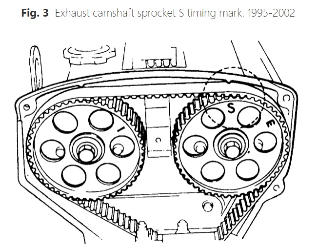

23.Rotate the crankshaft in the normal direction until the exhaust camshaft sprocket "S" mark aligns with the rear cover mark, Fig. 3.
24.Torque the timing belt tensioner lock bolt to 27-38 ft. lbs.
25.Measure the timing belt deflection at the midway point between the two camshaft sprockets, which should be between .30-.33 inch with a force of 22 lbs. If the deflection is not within specifications, repeat steps 19 through 23.
26.On 1995-96 models, ensure the tensioner spring free length is 2.189 inches, Fig. 4. If not, replace the spring.
