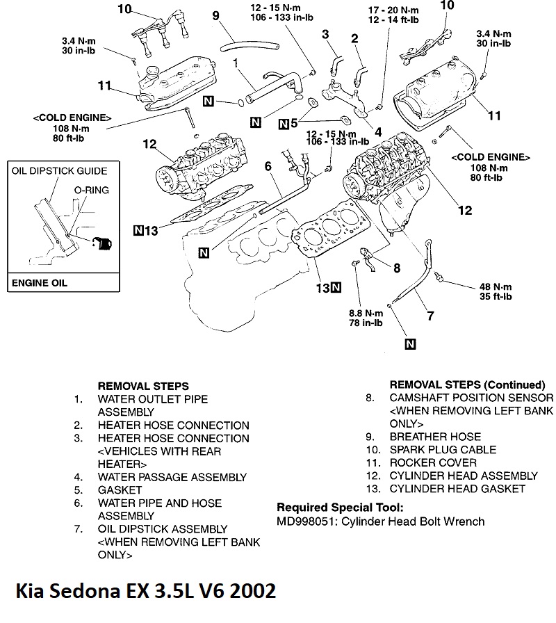

CYLINDER HEAD, REPLACE
1.Drain engine coolant into suitable container.
2.Remove timing belt as outlined in "Timing Belt, Replace."
3.Remove intake manifold as outlined in "Intake Manifold, Replace."
4.Disconnect front exhaust pipe as outlined in "Exhaust Manifold, Replace."

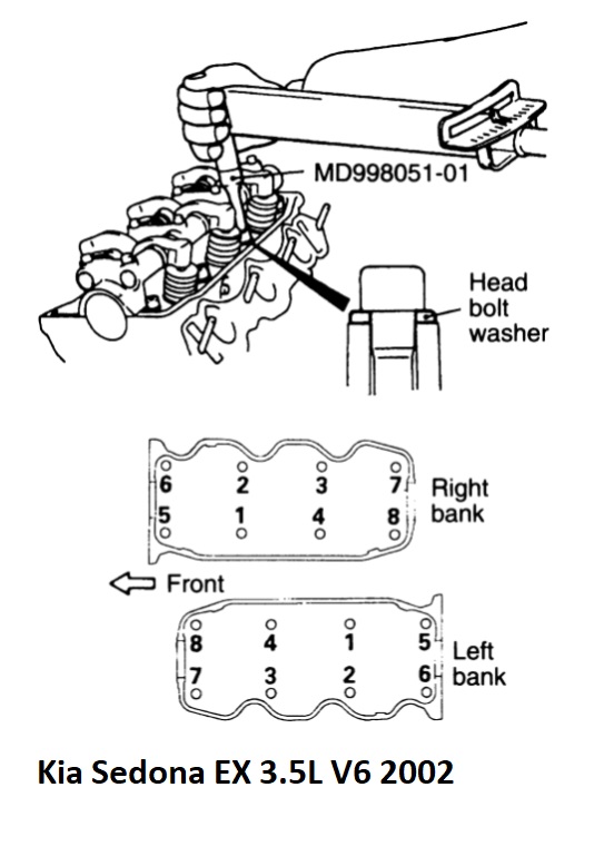

5.Remove cylinder head in numbered sequence, Fig. 1, noting the following. Remove cylinder head bolts in two or three steps using tool No. MD998051, or equivalent.
6.Reverse procedure to install, noting the following:
a.Ensure gasket mounting surface is clean of oil and grease, then place gasket on cylinder block with ID mark at front top position.
b.Torque cylinder head bolts in two or three steps, Fig. 2, to 80 ft. lbs.
c.Rinse mounting location of water pipe O-ring and water pipe with water, then install. Do not apply oil or grease to O-ring. Insert water pipe until its end bottoms.
d.Install water passage gasket onto water passage bending tabs of water passage, ensuring gasket does not slip.
e.Install thermostat with jiggle valve straight up.
    209,4 KB · Visitas: 446
    75,1 KB · Visitas: 664

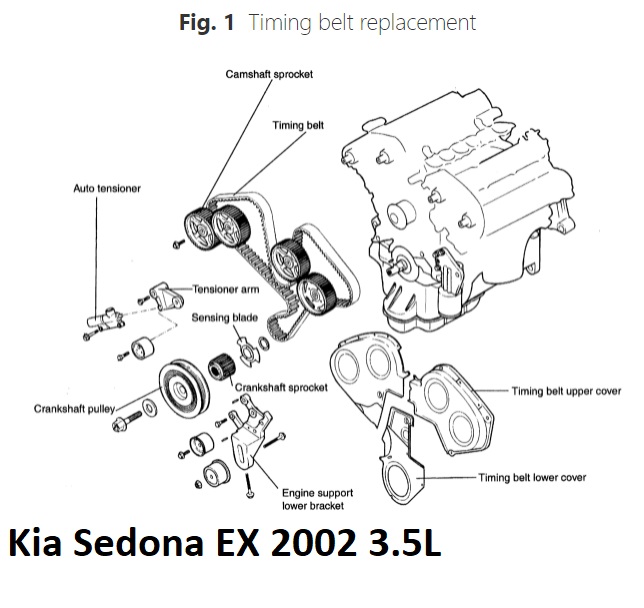

5.Remove the timing belt upper and lower covers, Fig. 1.

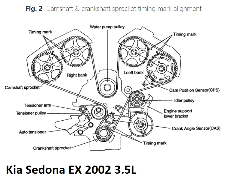

6.Rotate the crankshaft clockwise to align the crankshaft and camshaft timing marks and set the No. 1 piston at TDC compression stroke, Fig. 2.

14.Ensure the crankshaft and camshaft sprocket timing marks are aligned.
15.Install the new timing belt over the crankshaft sprocket, idler pulley, lefthand exhaust camshaft sprocket, lefthand intake camshaft sprocket, water pump pulley, righthand intake camshaft pulley, righthand exhaust camshaft sprocket and the tensioner pulley.
16.On Amanti and Sedona models, proceed as follows:
a.Rotate the crankshaft 1/4 turn counterclockwise, then rotate clockwise and align the timing marks.

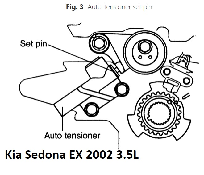

19.Remove the set pin from the auto-tensioner, Fig. 3.

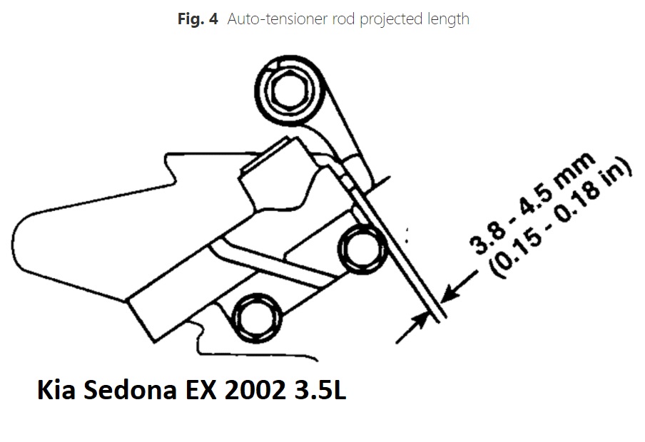

21.After waiting approximately five minutes, with No. 1 cylinder still at TDC compression stroke, measure the auto-tensioner rod projected length, which should be .15-.18 inch, Fig. 4.
22.If the auto-tensioner rod projected length is not within range, remove and install the timing belt once again.
    85,3 KB · Visitas: 767
    127 KB · Visitas: 1.776
    88,9 KB · Visitas: 905
    80,8 KB · Visitas: 387
