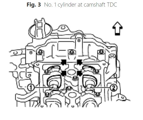

14.Ensure that cam noses of No. 1 cylinder are located as outlined, Fig. 3.
15.If not, rotate crankshaft pulley 360°.

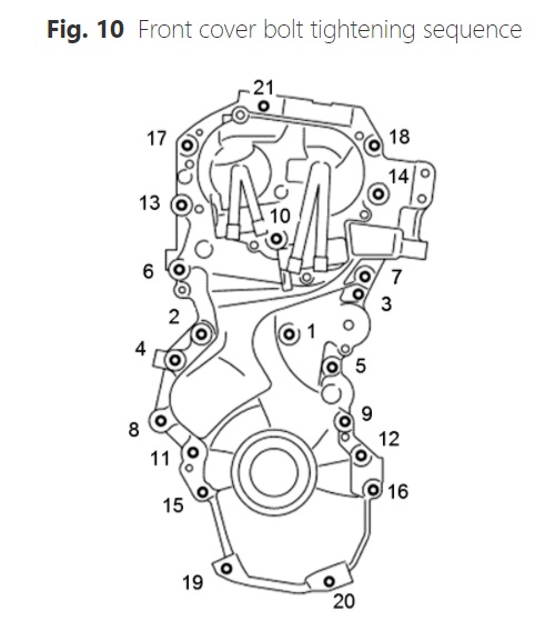

43.Install front cover, and tighten bolts in sequence, Figs. 5 and 10.
a.Torque M6 bolt to 58 inch lbs.
b.Torque M10 bolts to 41 ft. lbs.
c.Torque M12 bolts to 55 ft. lbs.
d.Torque M8 bolts to 19 ft. lbs.

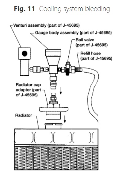

58.Bleed cooling system as follows:
a.Set heater temperature control lever to Max Hot position.
b.Remove radiator fill cap, air relief plug and bleeder cap, Fig. 11.
c.Fill radiator and reservoir tank with coolant. Air relief plug should be installed once coolant spills from hole during filling.
d.Install air bleeder cap.
e.Install a suitable steel wire under radiator fill cap to allow coolant to pass into reservoir tank regardless of system pressure.
f.Start engine and raise engine temperature to normal operating temperature.
g.Run engine at 2500 RPM for ten seconds and return to idle. Repeat two or three times. Watch engine coolant temperature gauge so engine does not overheat.
h.Stop engine and allow to cool.
i.Fill radiator and reservoir as required.
j.Repeat steps 7 through 9 two or three times.
k.Remove steel wire and install filler cap.
l.Raise engine temperature to normal and inspect for sounds of coolant flow while running engine from idle to 4000 RPM.
m.If sound is heard, bleed air from system proceed to next step.
n.Allow engine to cool.
o.Remove air bleeder cap on heater inlet hose.
p.Attach a suitable transparent hose at air bleeder pipe and place other end into coolant reservoir tank.
q.Start engine and inspect for bubbles in reservoir tank.
r.Set heater temperature control lever to Max Cool position.
s.Run engine at 2300 RPM until bubbles disappear. Caution: Do not run engine over 2300 RPM because engine damage may occur due to reduced coolant flow.
t.Set heater temperature control lever to Max Hot position and inspect for coolant flow sounds.
u.If sounds are present, repeat steps "r" through "t."
v.If sounds are not present, allow engine to cool, remove steel wire and hose attached to air bleeder, then install air bleeder cap.
