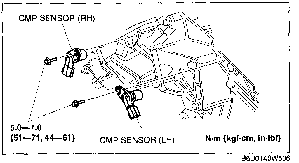

CAMSHAFT POSITION (CMP) SENSOR REMOVAL/INSTALLATION [AJ]
CAUTION: Do not forcefully pull the wiring harness of the CMP sensor. Doing so will break the harness.
1. Disconnect the negative battery cable.
2. Disconnect the CMP sensor connector.
3. Remove the CMP sensor.
CAUTION: When foreign material such as an iron chip is on the CMP sensor, it can cause abnormal output from the sensor because of flux turbulence and adversely affect the engine control. Be sure there is no foreign material on the CMP Sensor when replacing.
4. Install in the reverse order of removal.
    175,8 KB · Visitas: 502
