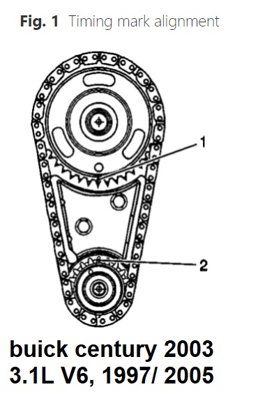

24.Rotate crankshaft until timing marks align, Fig. 1.

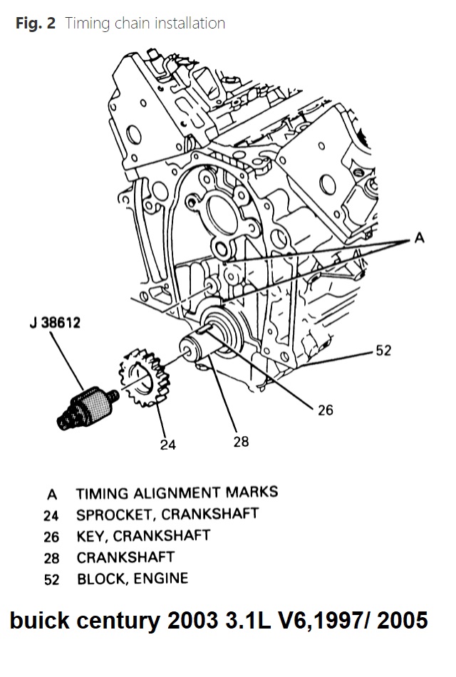

a.Install crankshaft sprocket until it is fully seated on flange of crankshaft using sprocket installer GM tool No. J-38612, or equivalent.
b.Coat camshaft and crankshaft sprockets with suitable engine oil.
c.Hold camshaft sprocket with chain hanging down and align camshaft and crankshaft sprockets marks with engine block cast timing marks, Fig. 2.

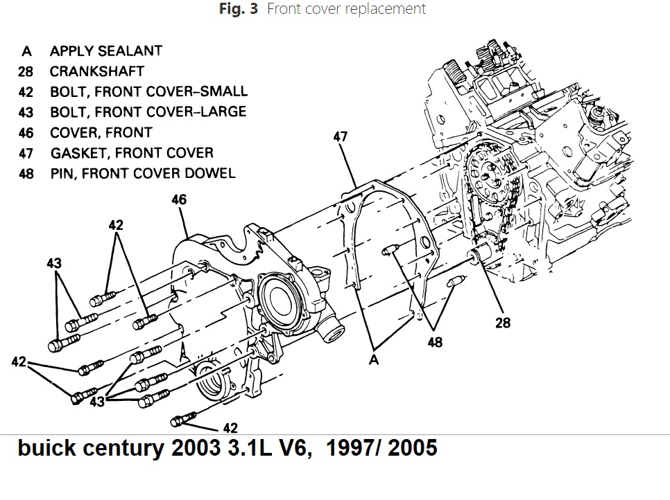

d.Install new front cover gasket.
e.Apply suitable sealant, Fig. 3.
