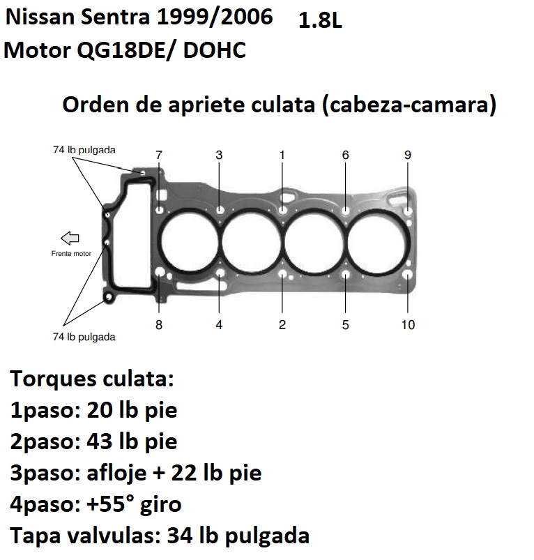

Hola amigos, les comparto los torques de culata para
Nissan Sentra 1.8L 1999/2006
Motor QG18DE/ DOHC
Torques culata:
1paso: 20 lb pie
2paso: 43 lb pie
3paso: afloje + 22 lb pie
4paso: +55° giro
Tapa valvulas: 34 lb pulgada
    122 KB · Visitas: 5.747

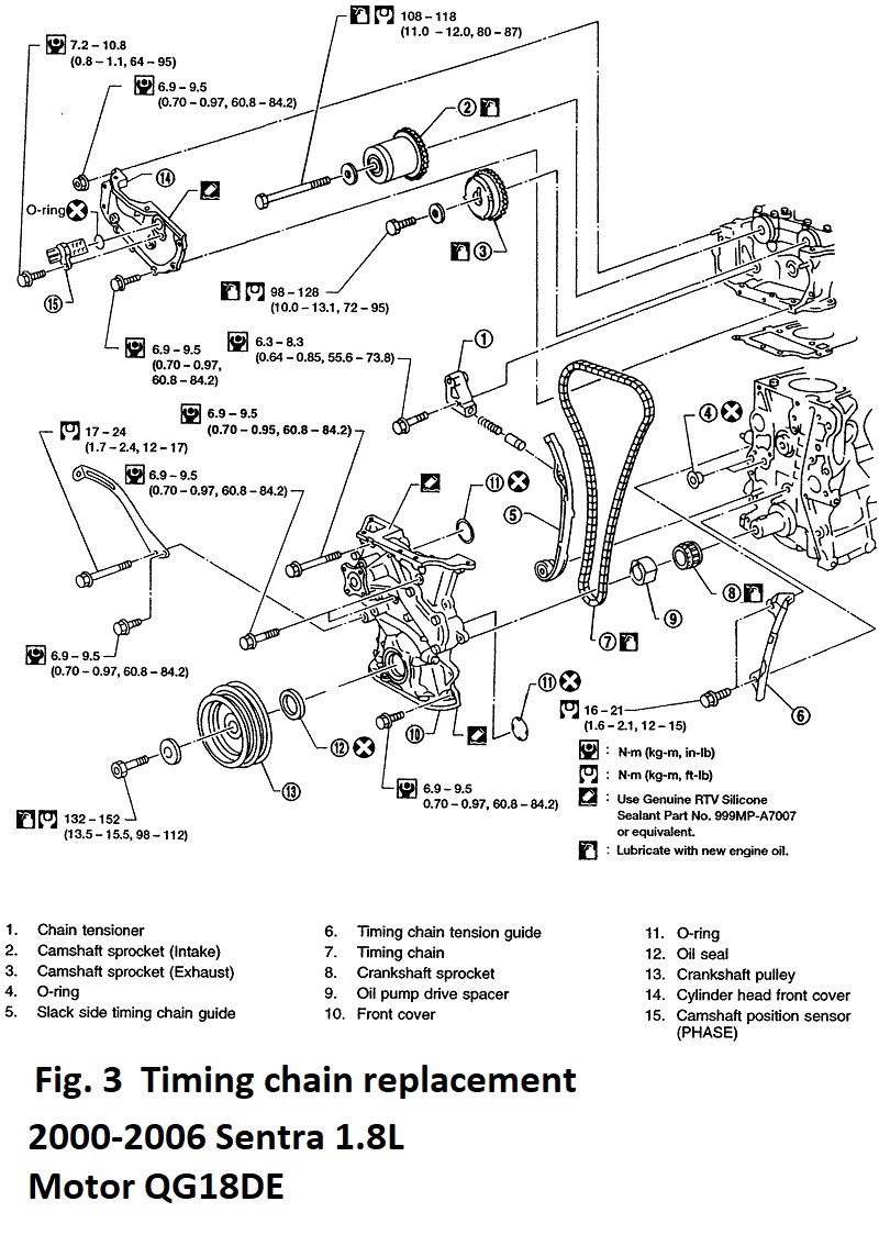

Cambiando banda de tiempo: sirve para 2000-2006 Sentra 1.8L
TIMING CHAIN, REPLACE
Caution: With timing chain removed, avoid turning camshaft or crankshaft. If movement is required, exercise extreme caution to avoid valve damage caused by piston contact.

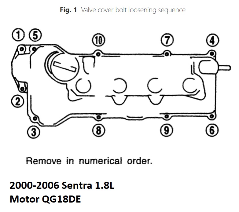

8.Remove valve cover bolts in sequence, Fig. 1, then valve cover.

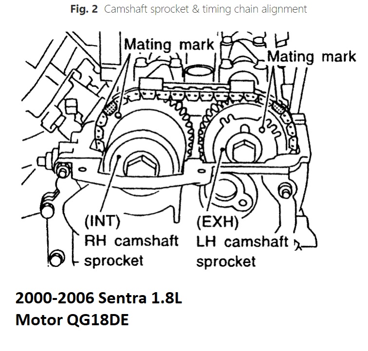

9.Set No. 1 piston at TDC on its compression stroke, rotate crankshaft until mating mark on camshaft sprocket is set in position, Fig. 2.

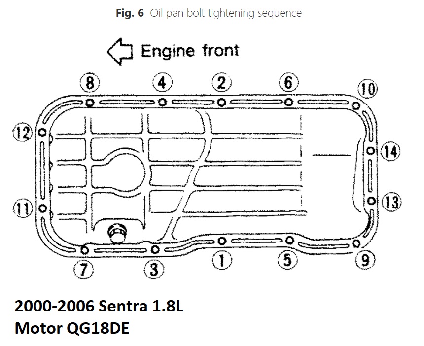

17.Remove oil pan mounting bolts, then oil pan.

30.Install camshaft sprockets. Align timing chain with camshaft sprocket alignment marks, Fig. 2.

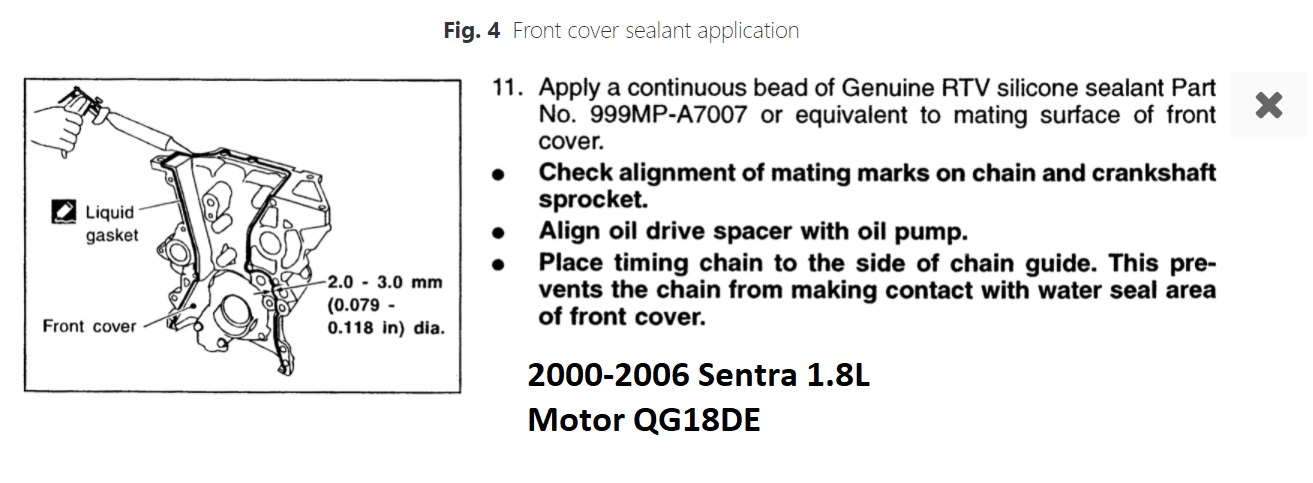

35.Remove any remaining RTV sealant from front cover and cylinder block mating surfaces.
36.Apply a continuous bead of suitable sealant to mating surface of front cover, Fig. 4.
37.Prior to installing front cover, inspect alignment of timing chain and crankshaft sprocket. Align oil drive spacer with oil pump and place timing chain to side of chain guide. This will prevent chain from making contact with water seal area of front cover.

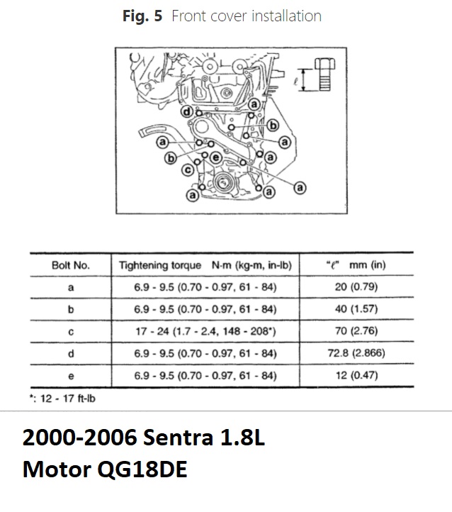

38.Install O-rings into front cover, then front cover. Tighten front cover bolts, Fig. 5.

43.Install oil pan as follows:
a.Apply a continuous bead of suitable RTV sealant to oil pan mating surface. Caution: Install oil pan within five minutes of sealant application.
b.Torque oil pan nuts and bolts to 74 inch lbs. in sequence, Fig. 6.

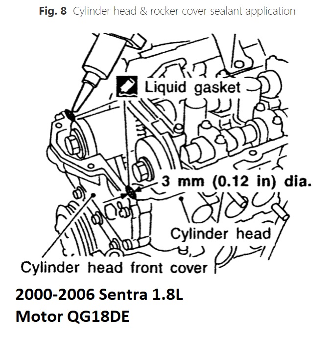

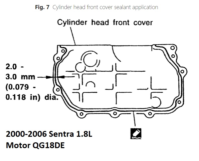

46.Apply a continuous bead of suitable RTV sealant to cylinder head front cover, Fig. 7.
47.Install CMP sensor.
48.Apply a bead of suitable RTV sealant to valve cover mating surface, Fig. 8.
    89,5 KB · Visitas: 733
    158,7 KB · Visitas: 2.945
    274,1 KB · Visitas: 1.229
    132,3 KB · Visitas: 1.092
    98,9 KB · Visitas: 2.102
    152,3 KB · Visitas: 1.003
    94,6 KB · Visitas: 904
    138,2 KB · Visitas: 1.108
