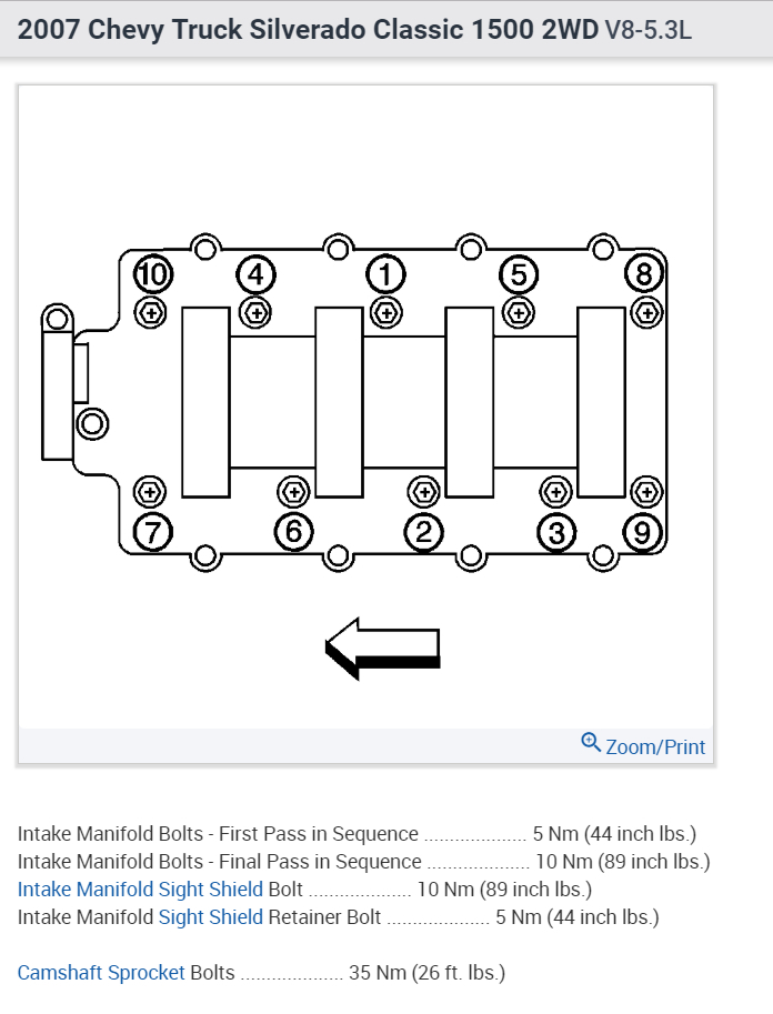

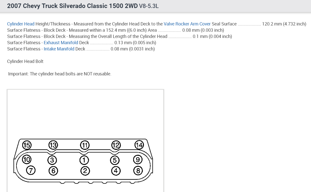

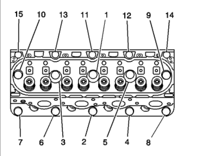

Hola, les comparto las especificaciones de torques de motor para un chevrolet silverado 2007 classic 1500 5.3L v8
Tighten the cylinder head bolts.
Tighten the M11 cylinder head bolts (1-10) a first pass in sequence to 30 N.m (22 lb ft).
Tighten the M11 cylinder head bolts (1-10) a second pass in sequence to 90 degrees using J 45059.
Tighten the M11 cylinder head bolts (1-10) a final pass to 70 degrees using J 45059.
Tighten the M8 cylinder head bolts (11-15) to 30 N.m (22 lb ft). Begin with the center bolt (11) and alternating side-to-side, work outward tightening all of the bolts.
