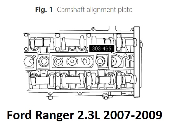

4.Install camshaft alignment plate tool No. 303-465, or equivalent, in slots on rear of both camshafts.
5.Camshaft alignment plate tool is for camshaft alignment only. Using tool to prevent rotation can result in engine damage, Fig. 1.

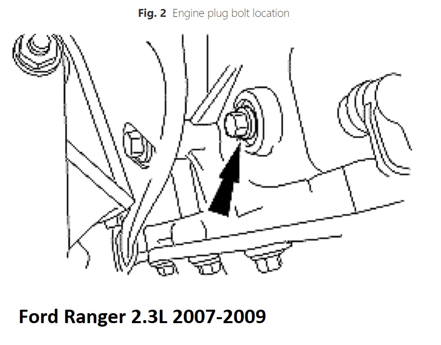

6.Remove engine plug bolt, Fig. 2.

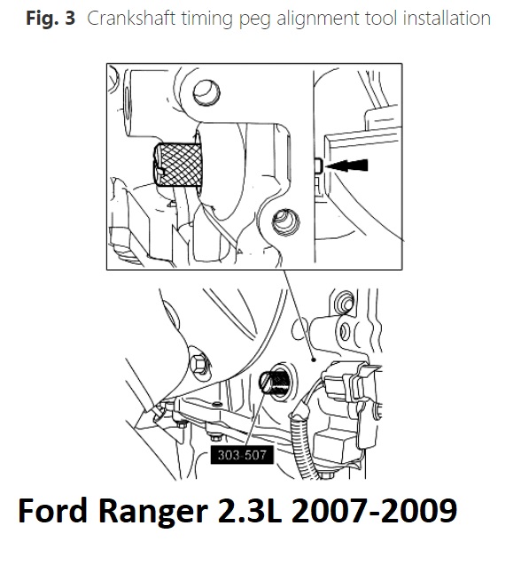

7.Install crankshaft timing peg tool No. 303-507, or equivalent, Fig. 3.
8.Only turn engine in normal direction of rotation. Installing timing peg tool will prevent engine from being rotated in clockwise direction, but engine can still be rotated in counterclockwise direction.

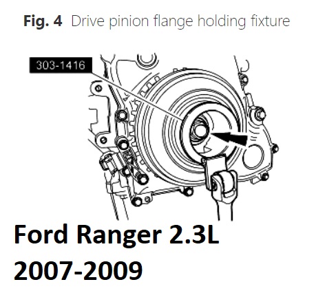

9.Install drive pinion flange holding fixture tool No. 303-1416, or equivalent, Fig. 4.
10.Failure to hold crankshaft pulley in place during bolt loosening can cause damage to engine.
11.Remove and discard crankshaft pulley bolt and drive pinion holding fixture, then the crankshaft pulley.

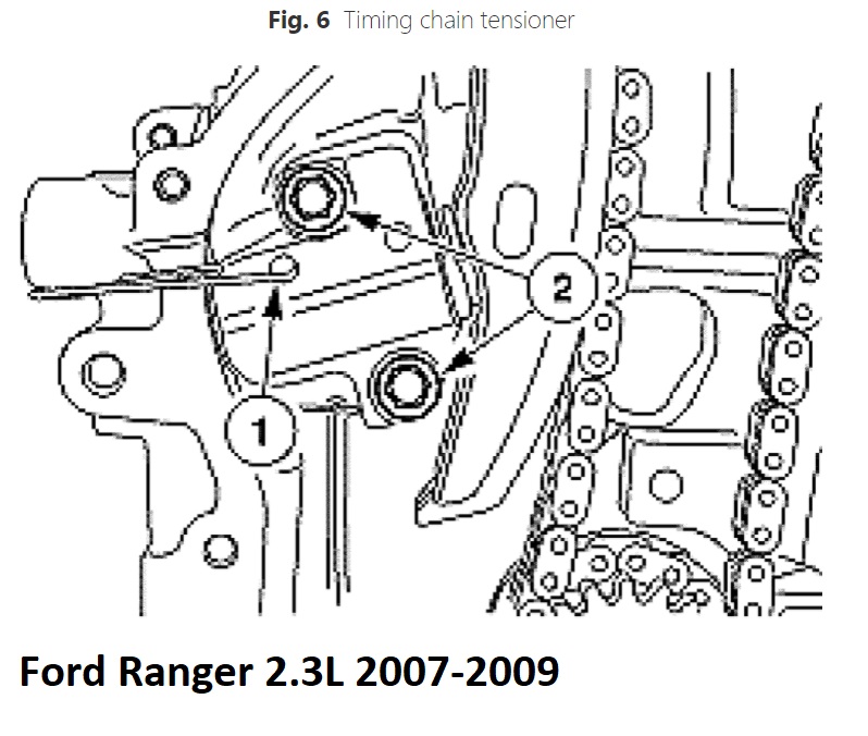

19.Compress timing chain tensioner and insert paper clip into tensioner hole, Fig. 6.
20.Remove tensioner. Caution: Do not rely on camshaft alignment plate to prevent camshaft rotation. Tool or camshaft may be damaged.

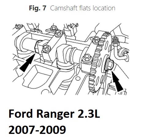

b.Prevent camshaft rotation using flats on camshaft, Fig. 7. Torque bolts to 53 ft. lbs.

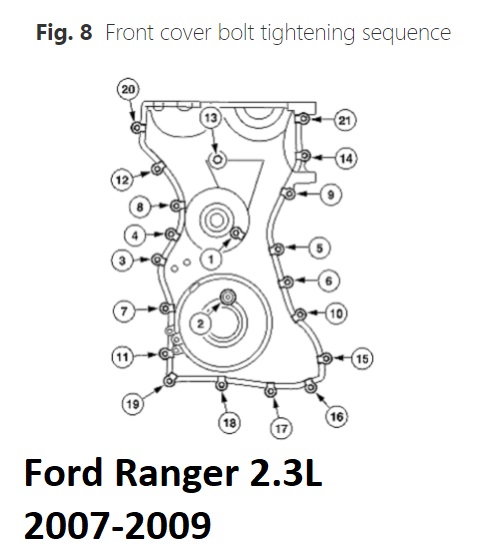

c.Tighten front cover bolts in sequence, Fig. 8. Torque 8mm bolts to 89 inch lbs.; 10mm bolts to 18 ft. lbs.; 13mm bolts to 35 ft. lbs.
