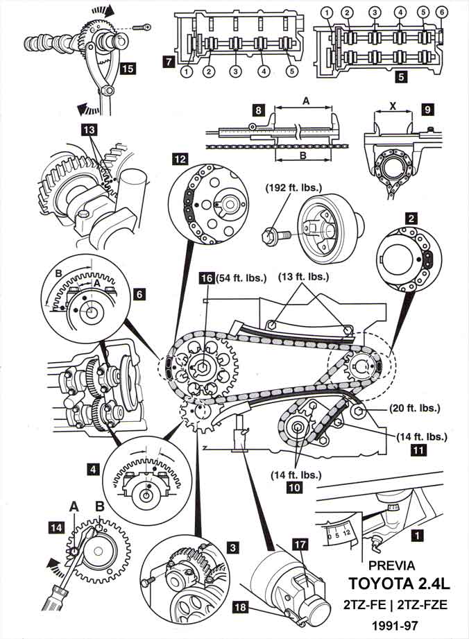

tiempo toyota previa

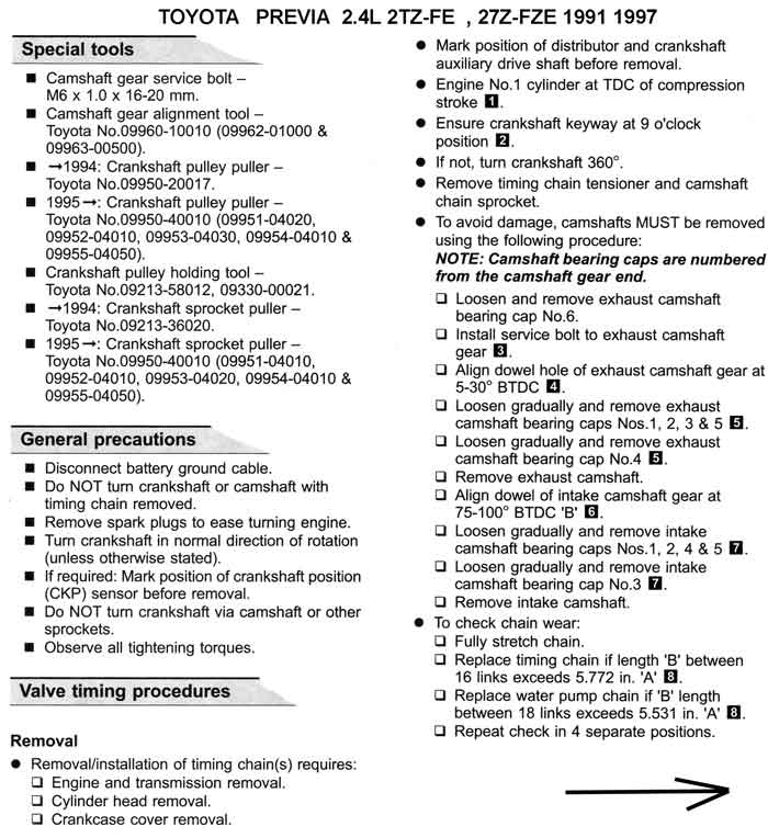

El esquema e indicaciones estan adjunto [ingles]
cadena de tiempo Toyota Previa 2.4L 1991/ 1997

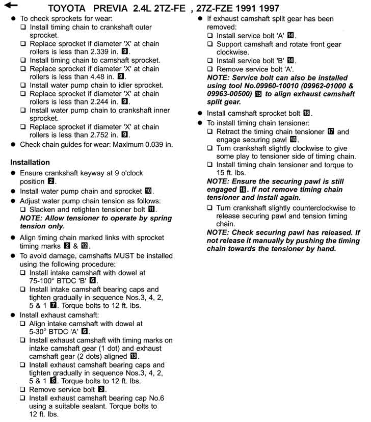

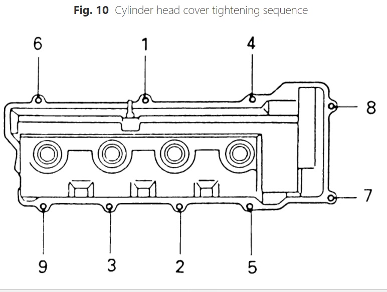

Comparto instrucciones para reemplazo de Cabeza
Toyota Previa LE 2.4L 4 cil 2TZ-FZE
CYLINDER HEAD, REPLACE

19.Place installation alignment marks on camshaft sprocket and chain.
20.Hold camshaft, then remove cam sprocket bolt.
21.Remove chain tensioner and gasket, remove cam sprocket and chain. Do not remove slipper and damper.
22.Remove No. 6 bearing cap bolt.

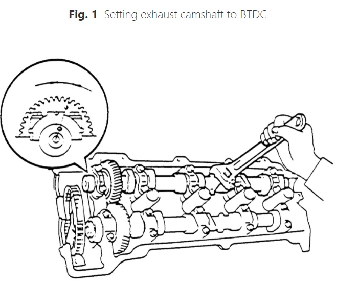

23.Remove exhaust camshafts as follows:
a.Camshaft must be held level during removal or cylinder head damage may result.
b.Set exhaust knock pin hole at 5-30° BTDC, Fig. 1.
c.Install service bolt to camshaft sub-gear and main gear.

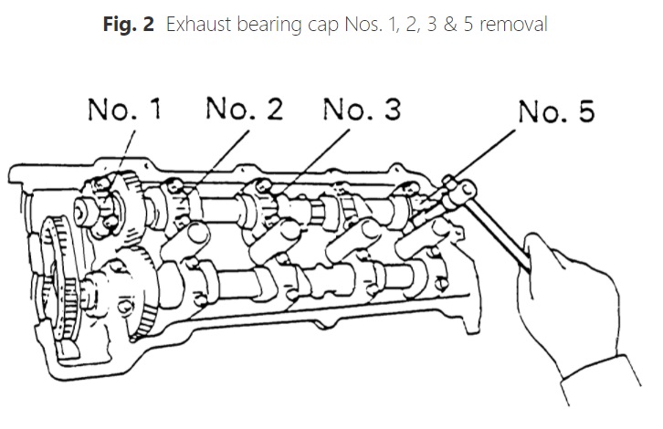

d.Alternately and uniformly loosen and remove Nos. 1, 2, 3 and 5 bearing caps in sequence shown Fig. 2.

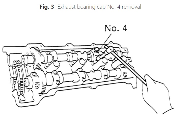

e.Alternately and uniformly loosen No. 4 bearing cap bolt, Fig. 3, ensure camshaft is being lifted straight out, if not retighten No. 4 cap and reverse camshaft removal procedure. Do not pry or force camshaft.
f.Remove No. 4 bearing cap and exhaust camshaft.

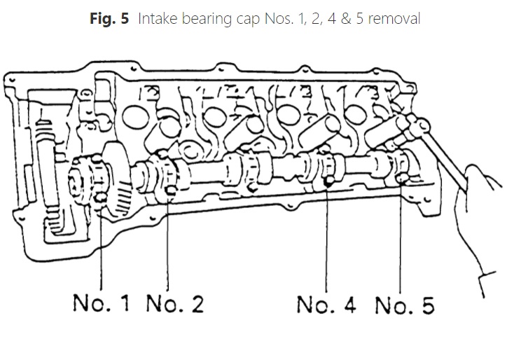

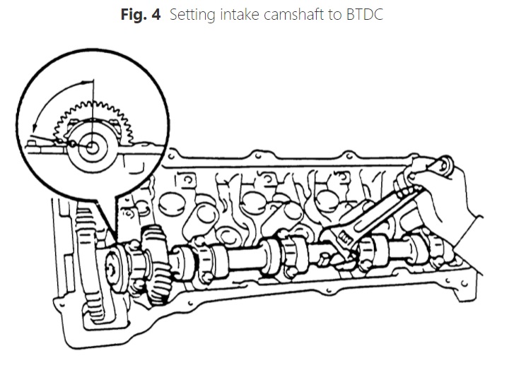

24.Remove intake camshafts as follows:
a.Set exhaust knock pin hole at 75-100° BTDC, Fig. 4.
b.Install service bolt to camshaft sub-gear and main gear.
c.Alternately and uniformly loosen and remove Nos. 1, 2, 4 and 5 bearing caps in sequence shown Fig. 5.

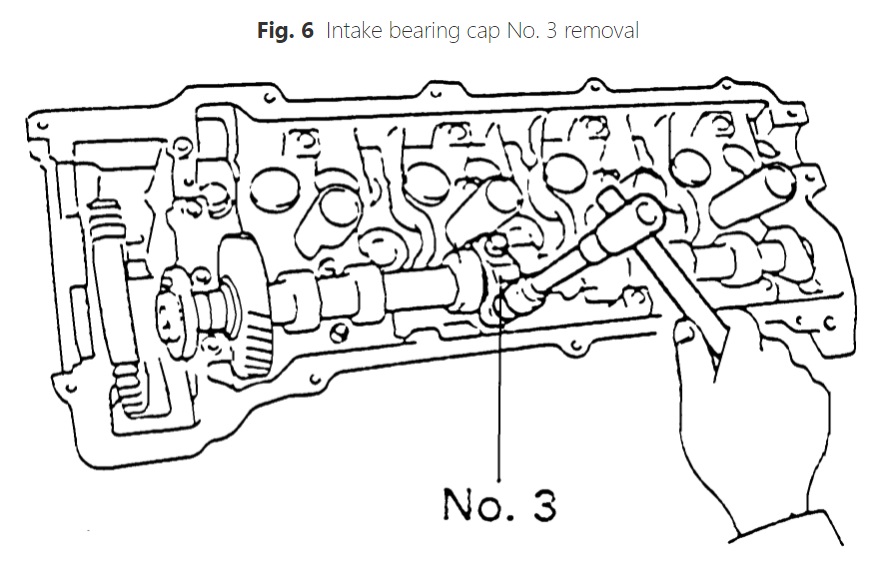

d.Alternately and uniformly loosen No. 3 bearing cap bolt, Fig. 6,ensure camshaft is being lifted straight out, if not retighten No. 3 cap and reverse camshaft removal procedure. Do not pry or force camshaft.
e.Remove No. 3 bearing cap and exhaust camshaft.

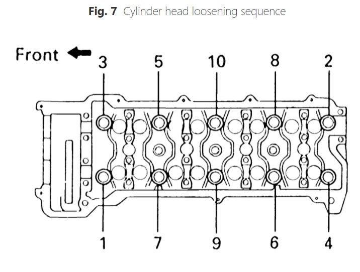

25.Remove two front cylinder head bolts, then remove cylinder head bolts, in sequence Fig. 7, in two or three steps.
26.Reverse procedure to install, noting the following:
a.Torque cylinder head bolts in reverse removal sequence, Fig. 7, in three step to 29 ft. lbs., then mark top front side of each bolt, then tighten an additional 90°, ensuring alignment mark is facing side ward, then tighten and additional 90°, ensuring alignment mark is facing rearward.
b.Torque two front cylinder head bolts to 15 ft. lbs.

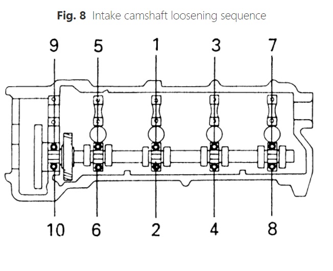

c.Torque intake bearing caps in sequence shown, Fig. 8, in three steps to 12 ft. lbs.

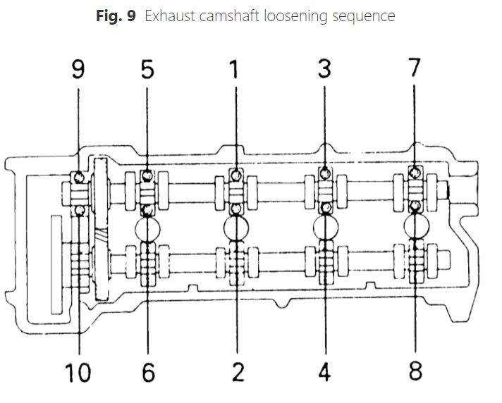

d.Torque exhaust bearing caps in sequence shown, Fig. 9, in three steps to 12 ft. lbs.
e.Torque cylinder head cover bolts in sequence shown, Fig. 10, to 69 inch lbs.
