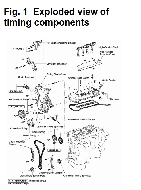

4.Release tensioner and remove drive belt, Fig. 1.

15.Remove attaching bolts, then seal washers and nuts.
16.Remove cable bracket, then cylinder head cover and gasket.

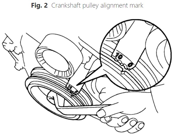

17.Set No. 1 cylinder to TDC of compression stroke by rotating crankshaft pulley as required to align pulley groove with "0" timing mark, Fig. 2.

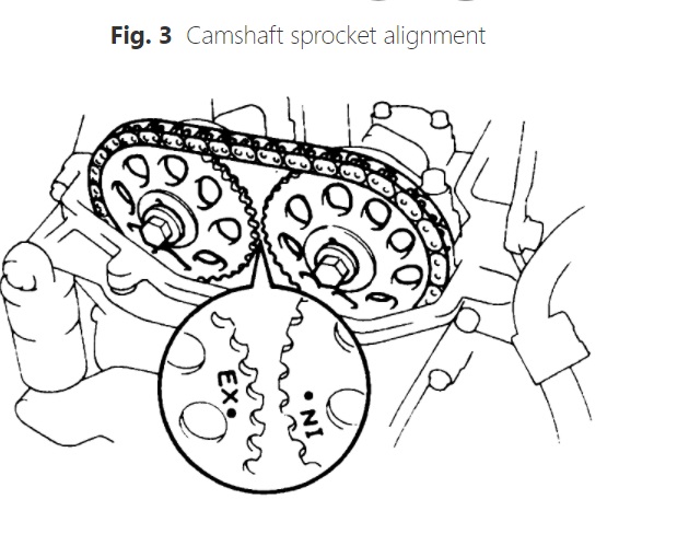

18.Ensure that point mark of camshaft timing sprockets are in straight line on timing chain cover surface, Fig. 3.
19.Remove pulley bolt, using crankshaft pulley holder tool Nos. 09213-70010, 09330-00021 or equivalents.
20.Remove crankshaft pulley, using crankshaft remover tool Nos. 09950-50011, 09951-05010, 09952-05010, 09953-05020 and 09954-05020 or equivalents.
21.Remove crankshaft position sensor, then drive belt tensioner.
22.Remove righthand engine mounting bracket.
23.Remove chain tensioner, then water pump.
24.Remove timing chain cover retaining bolts, then nuts.
25.Remove stud bolt, using a Torx wrench socket (E8) or equivalent.
26.Remove timing chain cover by prying portions between cylinder head and cylinder block. Caution: Ensure not to damage contact surface of timing chain cover, cylinder head and cylinder block.
27.Remove crank angle sensor plate, then chain tensioner slipper.
28.Remove timing chain and crankshaft timing sprocket.
29.Remove chain vibration damper, then camshaft timing sprockets.

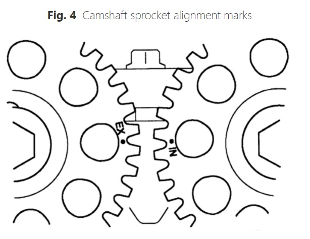

1.Install camshaft timing sprockets.
2.Align point marks of camshaft timing sprockets, Fig. 4.

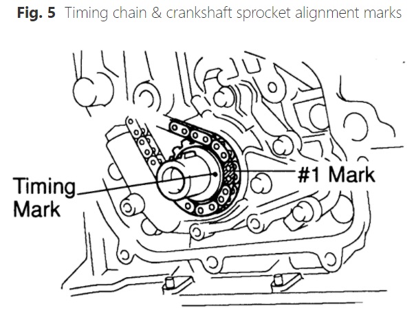

5.Install timing chain on crankshaft timing sprocket with No. 1 mark link aligned with mark on crankshaft timing sprocket, using installation tool No. 09223-22010 or equivalent, Fig. 5.

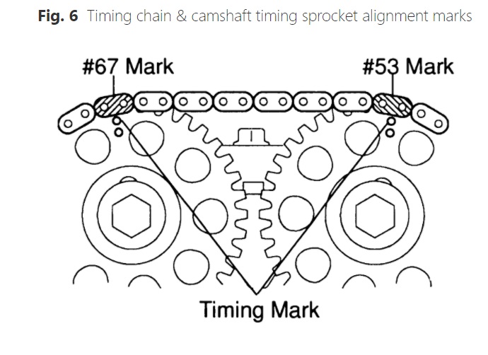

6.Install timing chain on camshaft timing sprocket with No. 53 and No. 67 mark links aligned with timing marks on camshaft timing sprockets, Fig. 6.

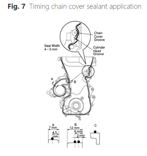

9.Apply sealant part No. 08826-00100 or equivalent to timing chain cover, Fig. 7. Install a nozzle that has been cut to a .16-.02 inch opening.

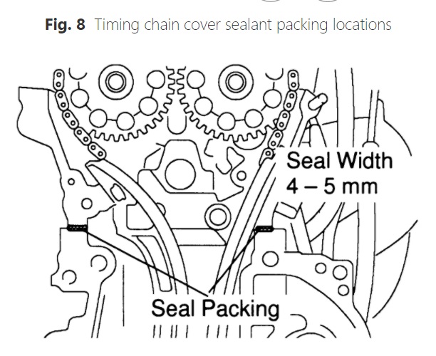

10.Apply sealant part No. 08826-00080 or equivalent to two locations, Fig. 8. Install a nozzle that has been cut to a .16-.02 inch opening.

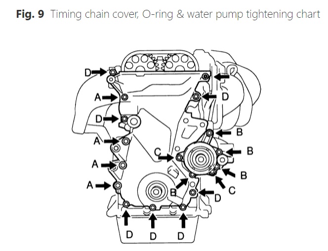

11.Install timing chain cover, O-ring and water pump. Tighten bolts as follows:
a.Torque 10 mm C bolts to 80 inch lbs.
b.Torque 10 mm A bolts to 10 ft. lbs.
c.Torque remaining 10 mm bolts to 96 inch lbs.
d.Torque 12 mm bolts to 14 ft. lbs., as outlined in Fig. 9.

20.Rotate crankshaft pulley and align its groove with timing mark "0" of timing chain cover.
21.Ensure that point marks of timing sprocket are in straight line on timing chain cover surface, Fig. 3.

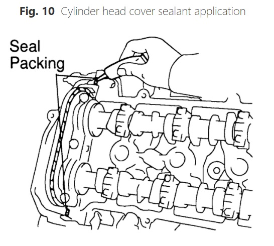

22.Apply sealant part No. 08826-00080 or equivalent to proper location, Fig. 10.

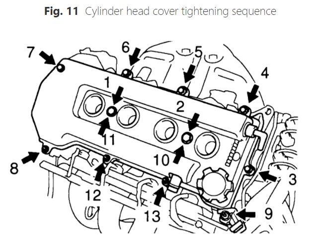

24.Install cylinder head cover, then cable bracket with bolts, sea washers and nuts.
25.Uniformly tighten bolts and nuts using sequence outlined in Fig. 11. Torque with washers to 96 inch lbs.; less washers to 80 inch lbs.
