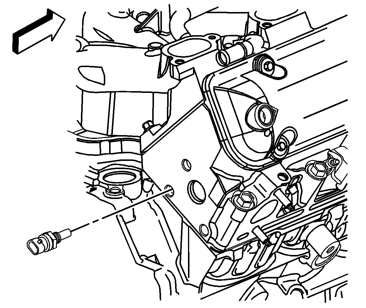

imagen1
3. Disconnect the ECT sensor harness connector.
4. Remove the ECT sensor.

Imagen 2
1. Apply thread sealant GM P/N 12345382 (Canadian P/N 10953489) or equivalent, to sensor threads.
IMPORTANT: Tap out sensor mounting hole in engine head to remove any thread sealant residue. Clean any sealant residue from old sensor and apply RTV sealant to threads if old sensor is going to be reused.
2. Install the ECT sensor.
