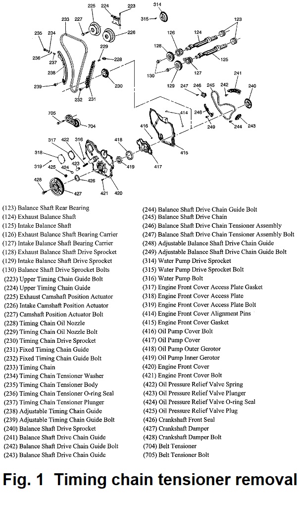

4.Remove upper timing chain guide, then timing chain tensioner, Fig. 1.

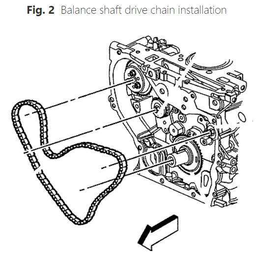

a.If installing balance shaft drive chain, align balance shaft drive chain colored links with marks on balance shaft drive sprockets and crankshaft sprocket as follows: Align colored link with timing mark on intake side balance shaft sprocket, Fig. 2, align chrome link with timing mark on balance shaft drive sprocket (approximately 6 o'clock position on sprocket), place chain link on water pump drive sprocket (alignment is not critical), align last chrome link with timing mark on exhaust side balance shaft drive sprocket.
b.Rotate balance shaft drive chain tensioner plunger 90° in its bore and compress plunger, then rotate tensioner back to original 12 o'clock position and insert a paper clip through hole in plunger body and into hole in tensioner plunger.
c.Install balance shaft drive chain tensioner, then remove paper clip.

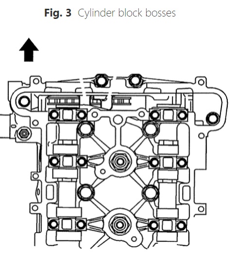

g.Lower timing chain through opening in cylinder head and ensure chain goes around both sides of cylinder block bosses, Fig. 3.

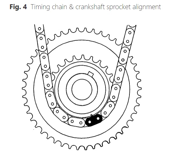

h.Route timing chain around crankshaft sprocket and align pink colored chain link to timing mark on sprocket, Fig. 4.

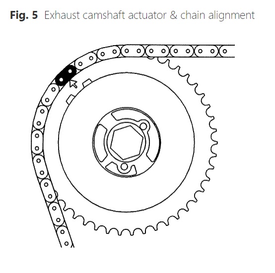

i.Install exhaust camshaft actuator, then install actuator bolt hand tight. Align actuator with last pink colored link on chain, Fig. 5.
