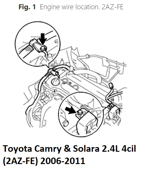

18.Remove the two bolts and disconnect the two engine wires, Fig. 1.

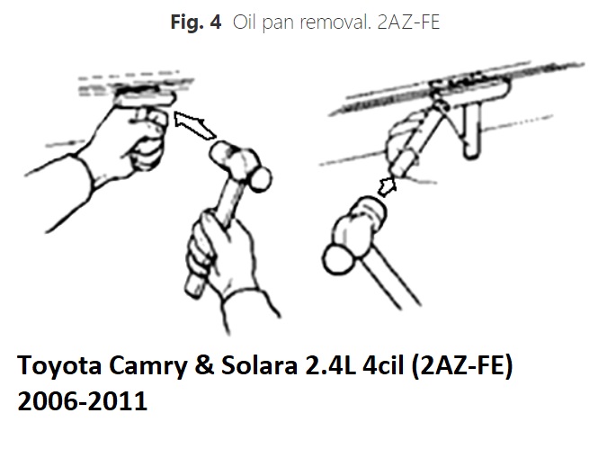

23.Remove the oil pan 12 bolts and two nuts, Fig. 3.
24.Insert the blade of an oil pan seal cutter between the crankcase and oil pan. Cut through the sealer and remove the oil pan, Fig. 4.

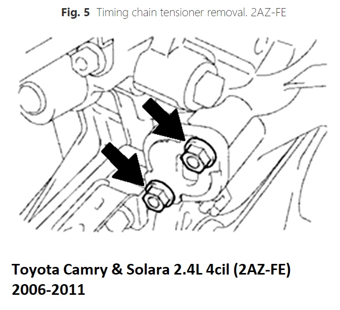

25.Remove the two nuts, No. 1 chain tensioner and gasket, Fig. 5.

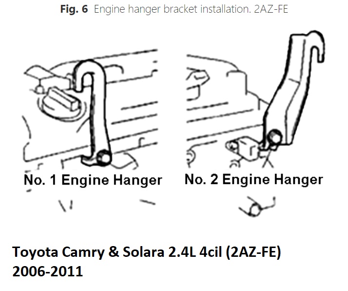

26.Install the No. 1 engine hanger and No. 2 engine hanger with the bolts. Torque bolts to 28 ft. lbs., Fig. 6.
27.Attach a sling device to the engine hangers and chain block.
28.Lift the engine upward using the chain block.

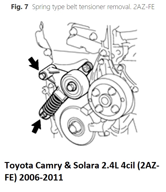

29.Remove the bolt, nut and spring type belt tensioner, Fig. 7.

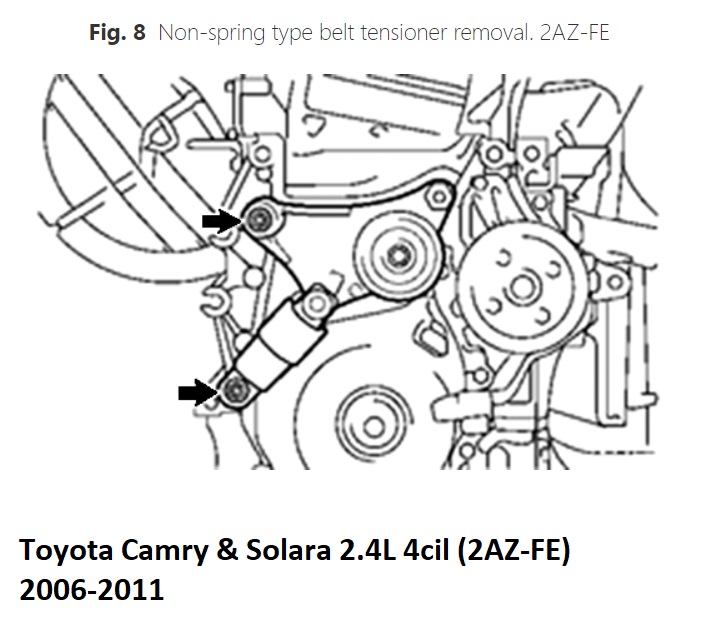

30.Remove the bolt, nut and non-spring type belt tensioner, Fig. 8.

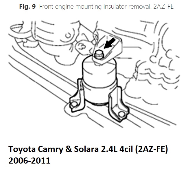

32.Remove the bolt and disconnect the front engine mounting insulator, Fig. 9.

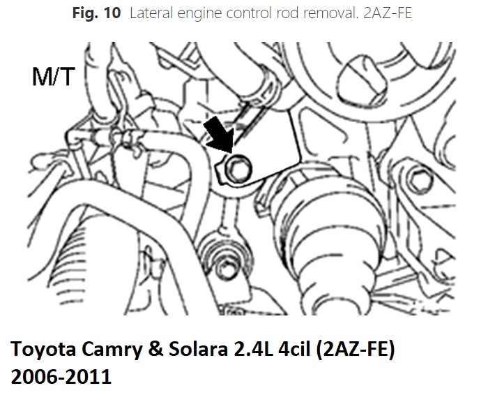

33.On models equipped with manual transaxle, remove the bolt and disconnect the engine lateral control rod, Fig. 10.

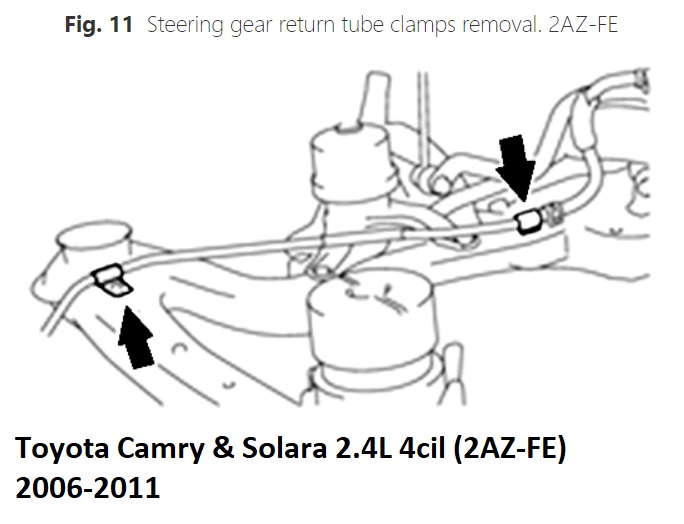

34.On all models, remove the two bolts and disconnect the steering gear return tube clamps from the frame, Fig. 11.

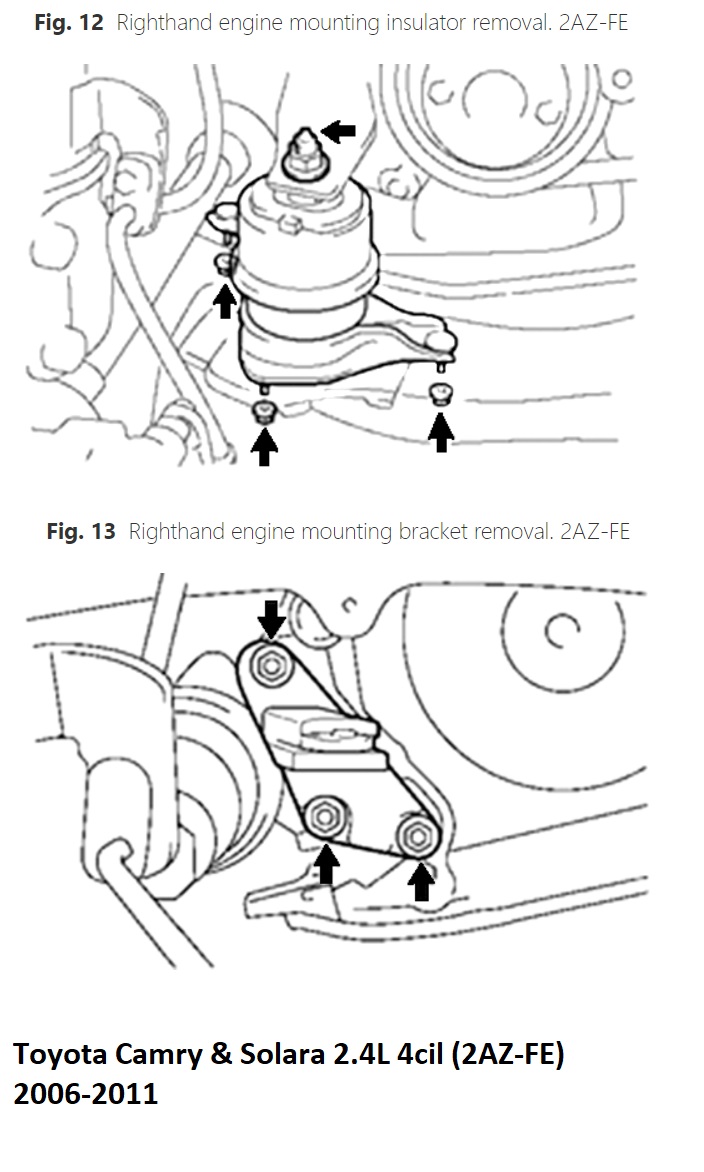

35.Remove the four nuts from the righthand engine mounting insulator, Fig. 12.
36.Raise the engine and remove the righthand engine mounting insulator, Fig. 12.
37.Remove the three bolts and righthand engine mounting bracket, Fig. 13.

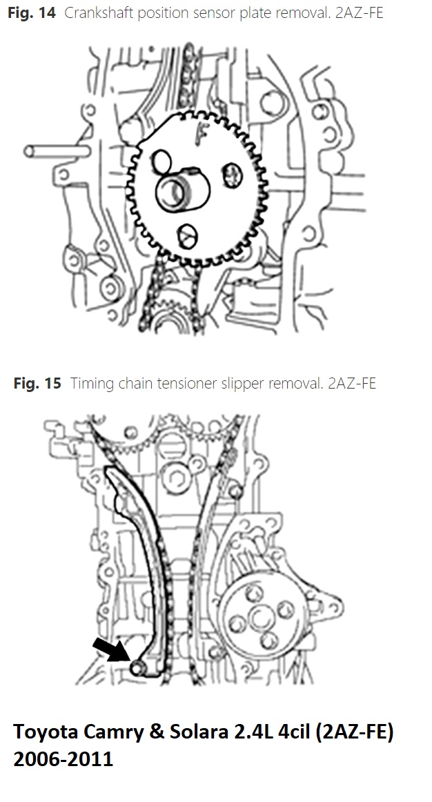

40.Remove the crankshaft position sensor plate, Fig. 14.
41.Remove the bolt and chain tensioner slipper, Fig. 15.

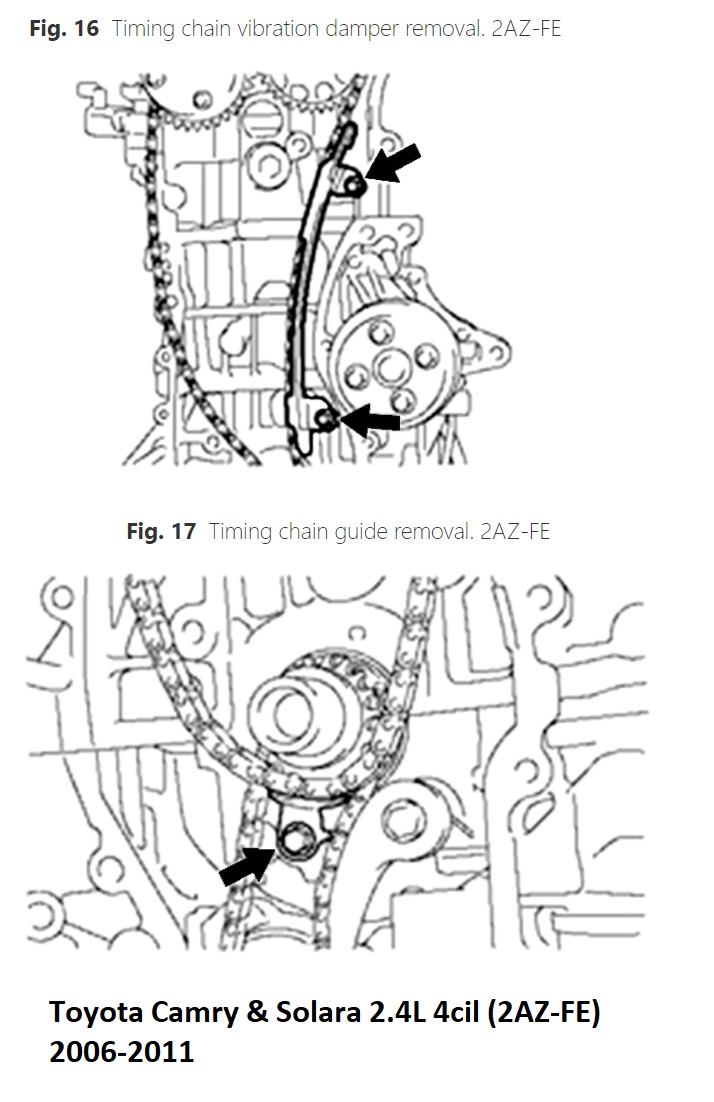

42.Remove the two bolts and chain vibration damper, Fig. 16.
43.Remove the bolt and timing chain guide, Fig. 17.

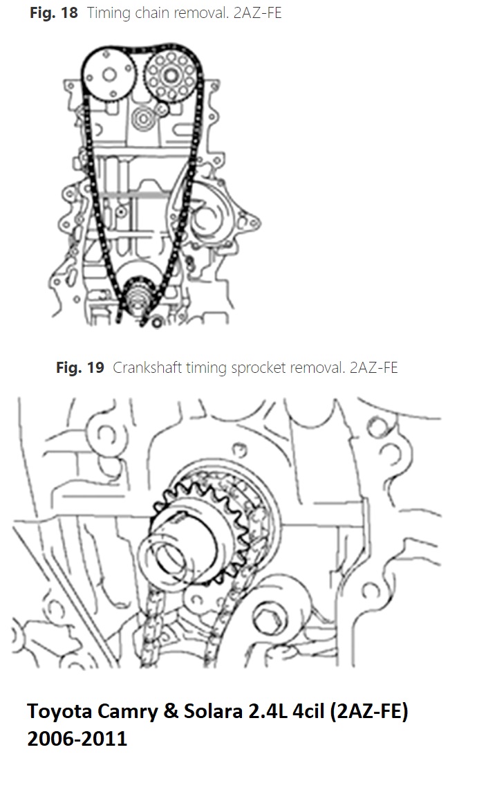

44.Remove the chain sub-assembly, Fig. 18.
45.Remove the crankshaft timing sprocket, Fig. 19.

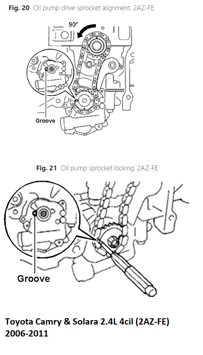

46.Turn the crankshaft by 90° counterclockwise to align the adjusting hole of the oil pump drive shaft sprocket with the groove of the oil pump, Fig. 20.
47.Insert a 4 mm diameter pin into the adjusting hole of the oil pump drive shaft sprocket to lock the gear in position, and then remove the nut, Fig. 21.

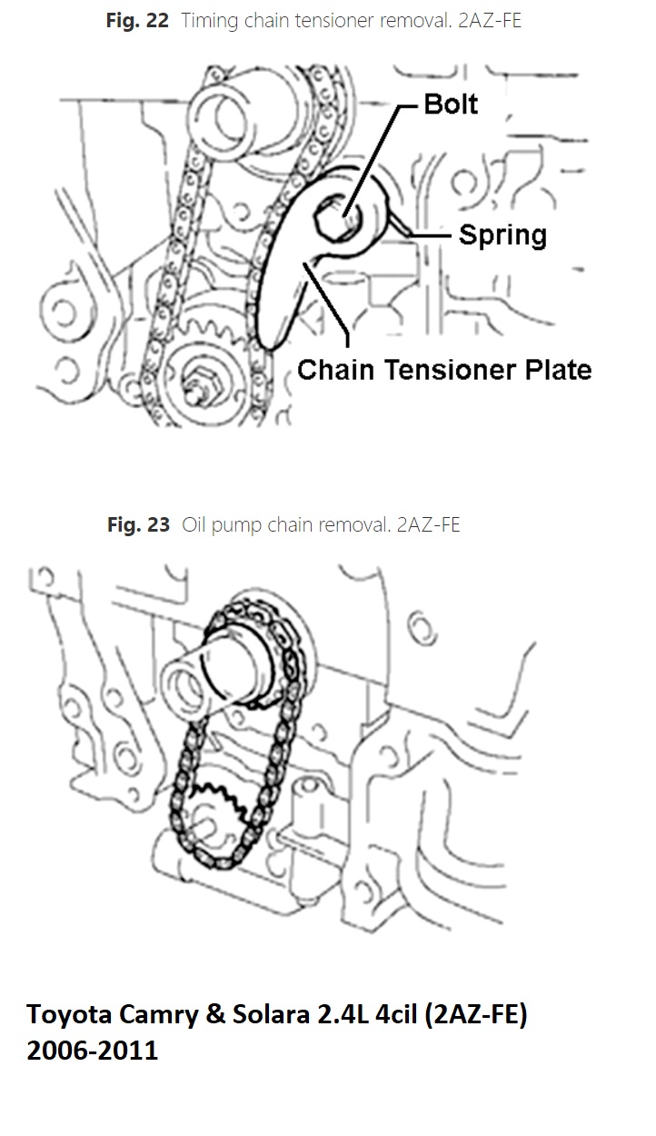

48.Remove the bolt, chain tensioner plate and spring, Fig. 22.
49.Remove the chain tensioner, oil pump driven sprocket and chain, Fig. 23.

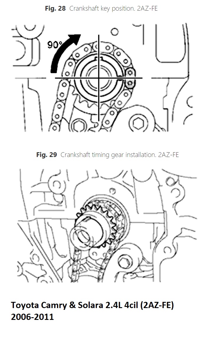

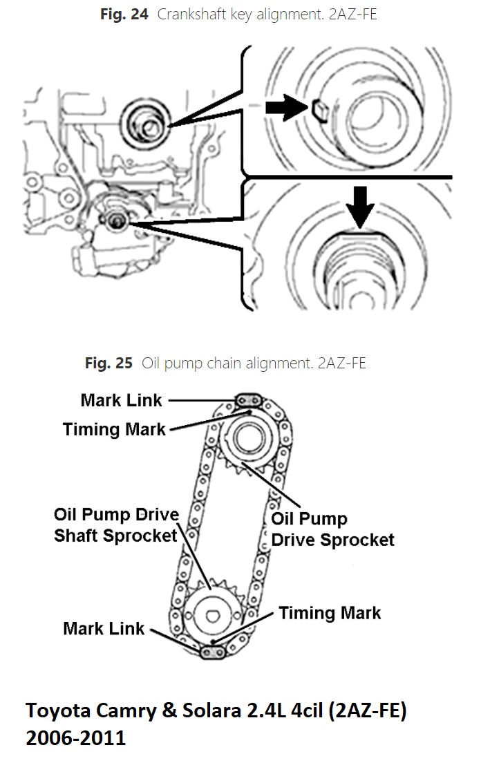

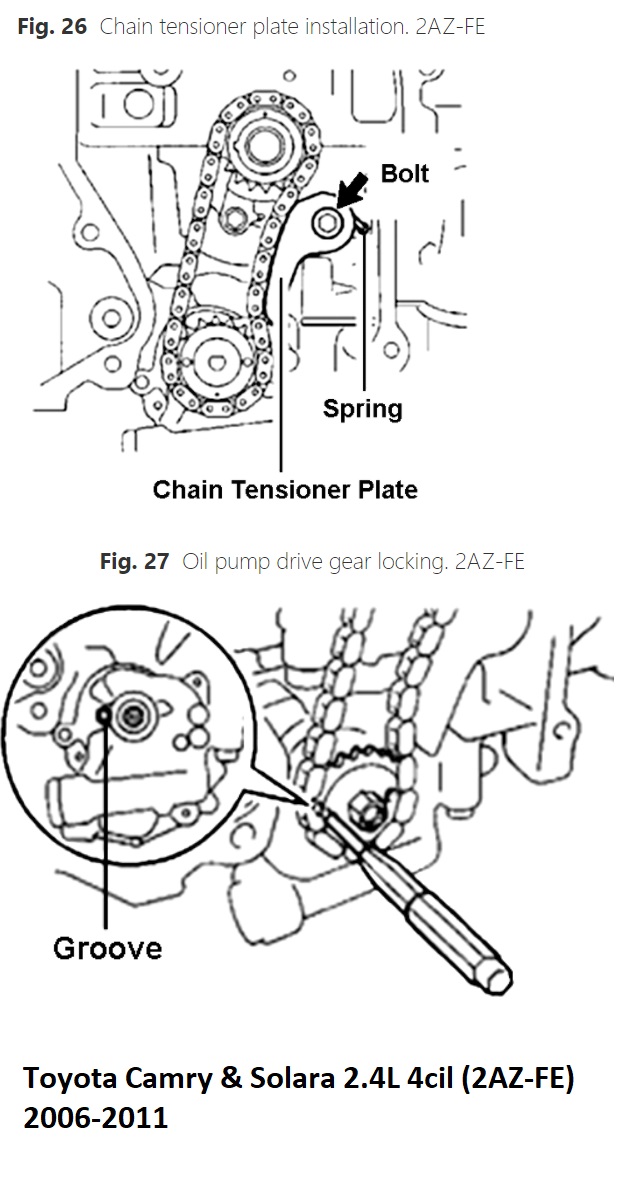

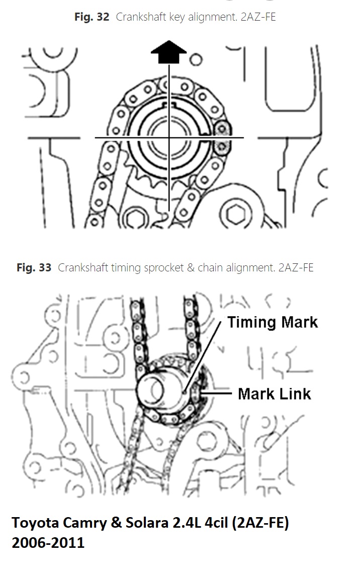

1.Set the crankshaft key into the left horizontal position, Fig. 24.
2.Turn the drive shaft so that the cutout faces upward, Fig. 24.
3.Align the yellow mark links with the timing marks of each gear, Fig. 25.
4.Install the sprockets onto the crankshaft and oil pump shaft with the chain wrapped on the gears, Fig. 25.
5.Temporarily tighten the oil pump drive shaft sprocket with the nut, Fig. 25.
6.Insert the damper spring into the adjusting hole, and then install the chain tensioner plate with the bolt. Torque bolt to 108 inch lbs., Fig. 26.
7.Align the adjusting hole of the oil pump drive shaft sprocket with the groove of the oil pump, Fig. 26.
8.Insert a 4 mm diameter pin into adjusting hole of oil pump drive shaft gear to lock gear in position, and then tighten nut. Torque nut to 22 ft. lbs., Fig. 27.
9.Using the crankshaft pulley bolt, rotate the crankshaft clockwise by 90°, and align the crankshaft key to the top, Fig. 28.
10.Install the crankshaft timing sprocket, Fig. 29.

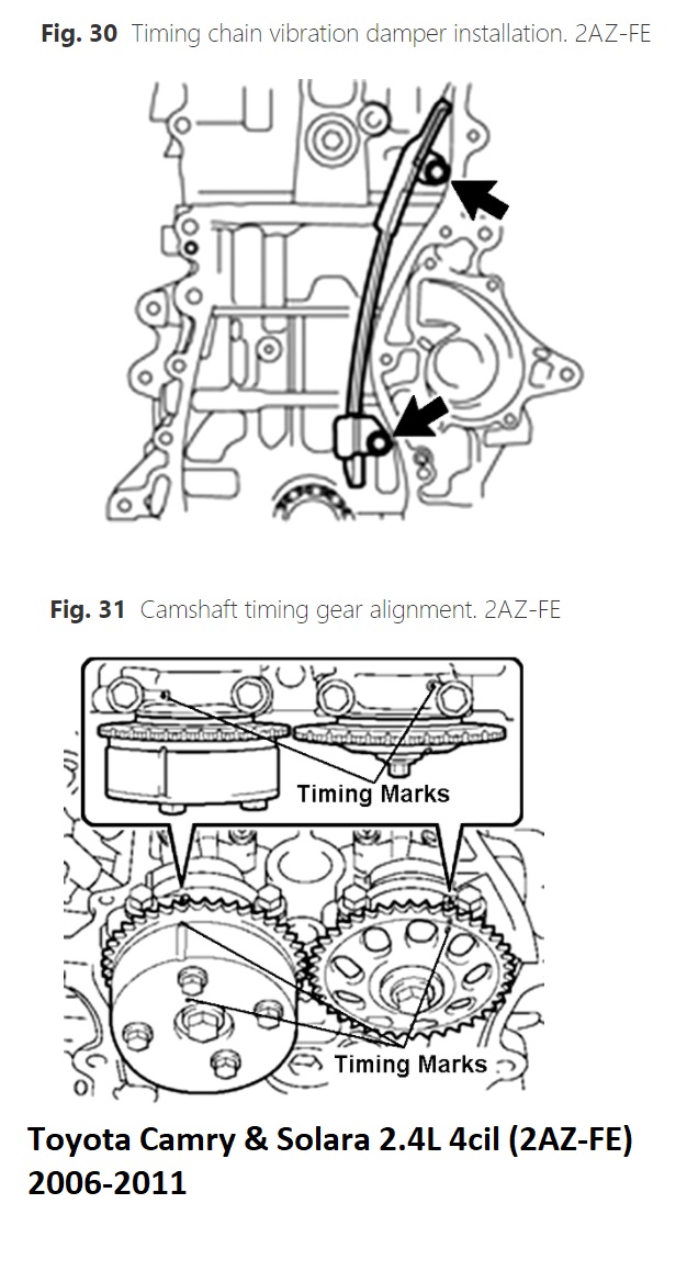

11.Install the chain vibration damper with the two bolts. Torque bolts to 80 inch lbs., Fig. 30.
12.Set the No. 1 cylinder to TDC/compression.
13.Turn camshafts with a wrench (using the hexagonal lobe) to align timing marks of camshaft timing gear with each timing mark located on No. 1 and No. 2 bearing caps, Fig. 31.
14.Using the crankshaft pulley bolt, turn the crankshaft to position the crankshaft key to face up, Fig. 32.

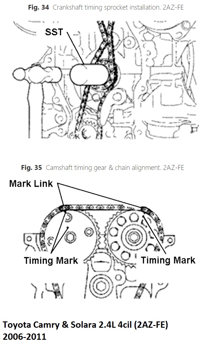

15.Install the chain onto the crankshaft timing sprocket with the gold or pink mark link aligned with the timing mark on the crankshaft, Fig. 33.
16.Using service tool No. 09309-37010, or equivalent and a hammer, tap in the crankshaft timing sprocket, Fig. 34.
17.Align the gold or yellow mark links with each timing mark located on the camshaft timing gear and sprocket, then install the chain, Fig. 35.

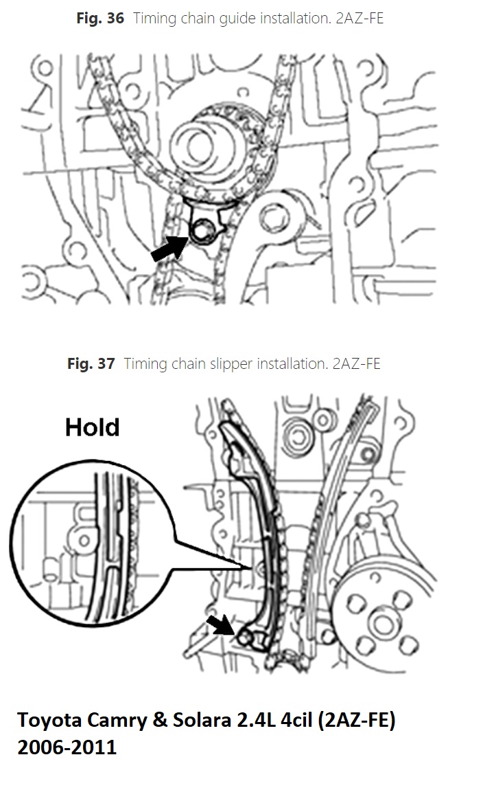

18.Install the timing chain guide with the bolt. Torque bolt to 80 inch lbs., Fig. 36.
19.Install the chain tensioner slipper with the bolt. Torque bolt to 14 ft. lbs., Fig. 37.

23.Install the V-ribbed belt spring type tensioner to engine by first tightening bolt and then tightening the nut. Torque fasteners to 44 ft. lbs.
24.Install the non-spring type belt tensioner with the bolt and nut. Torque fasteners to 44 ft. lbs.
25.Install the engine mounting bracket with the three bolts. Torque bolts to 40 ft. lbs.
26.Raise the engine and install the righthand engine mounting insulator.
27.Install the righthand engine mounting insulator with the four nuts. Torque nut A to 70 ft. lbs. and nut B to 64 ft. lbs.
28.Install the steering gear return tube clamps to the frame with the two bolts. Torque bolts to 69 inch lbs.
29.Install the front engine mounting insulator with the bolt. Torque bolt to 64 ft. lbs.
30.On models equipped with manual transaxle, install engine lateral control rod with bolt. Torque bolt to 66 ft. lbs.

37.Release the ratchet pawl, then fully push in the plunger and hook the hook to the pin so that the plunger is in the correct position, Fig. 41.
38.Install a new gasket and the chain tensioner with the two nuts. Torque nuts to 80 inch lbs.
39.Turn the crankshaft counterclockwise, then disconnect the hook from the plunger knock pin, Fig. 42.
40.Turn the crankshaft clockwise, then ensure that the plunger is extended, Fig. 43.
